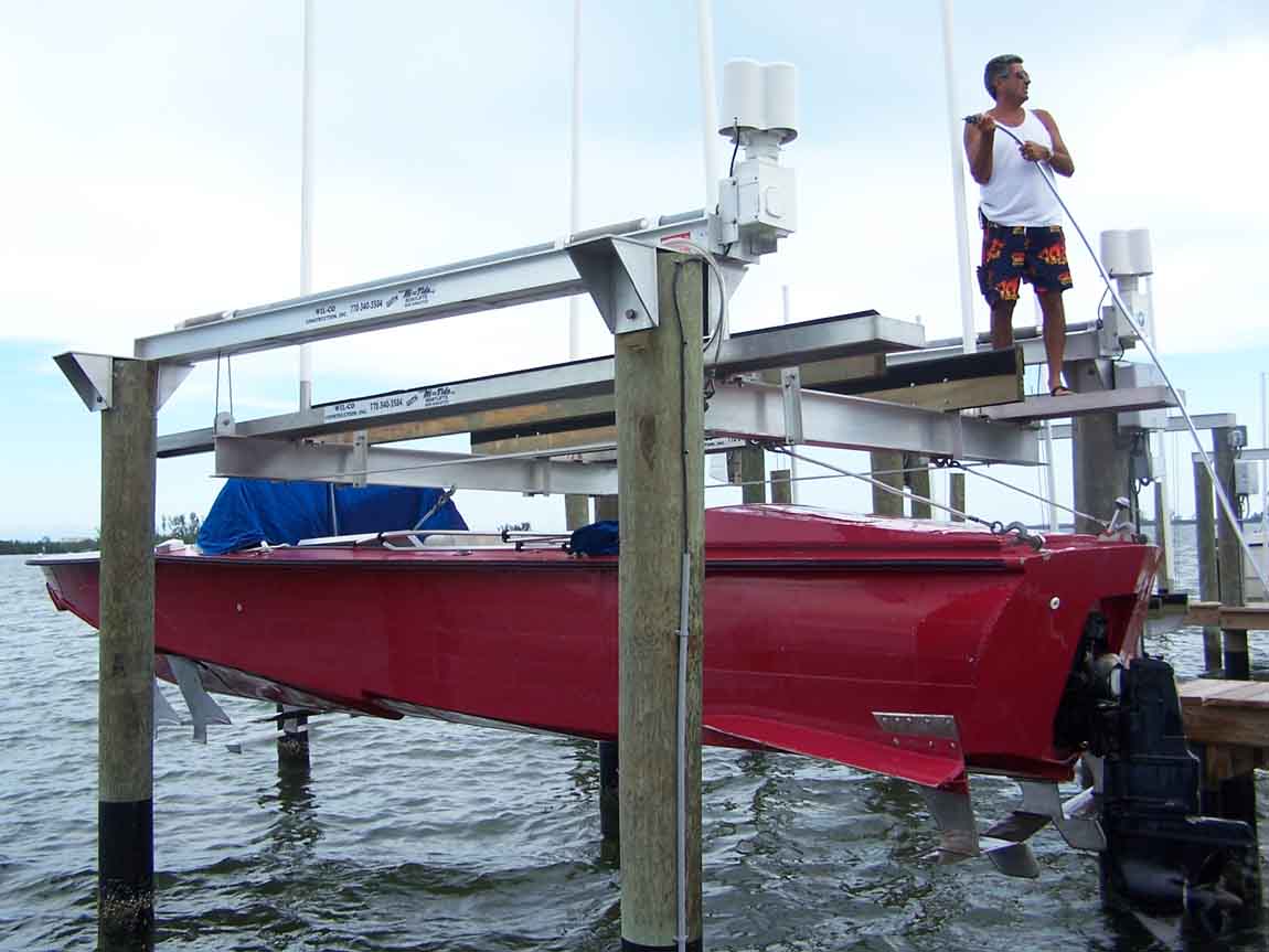

This is my boat before I changed the lower unit to a duo prop
