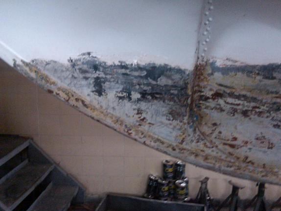

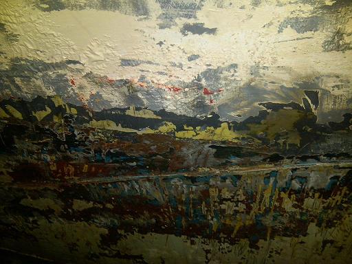

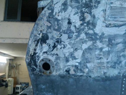

Hi Martin,
Here are some photos of this paint. It was encountered everywhere, where flat bolts and smooth hull was used. Between the aluminium sheets there was somekind of fabric, which was also drained in this paint. This paint being the last layer has been removed already from the hull. The upper deck has been cleared and the engine room is presently under paint removal. Last will be the passenger compartment.
Unless not encountering an insane pricing we will go for international paint for Aluminium hulls. Results will be posted.
Little damages or repairs were encountered on the hull. Probably boat was not used often and taken very good care off. The layers of paint where not more than 6 including antifoulings and priming paint.
Among 8 paint removals tested, most of them being unuseful or doing little to remove the paint, somekind of scandinavian Christin brand remover was extremely effective.
What looks like a piece of modern Art painting of Jackson Pollock is my Volga being stripped.
