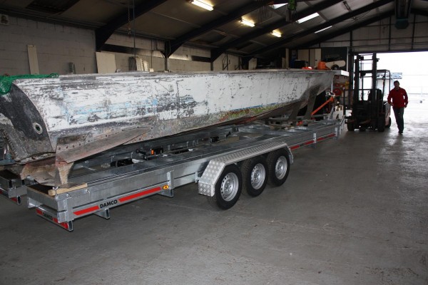

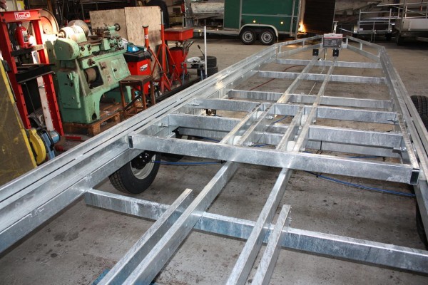

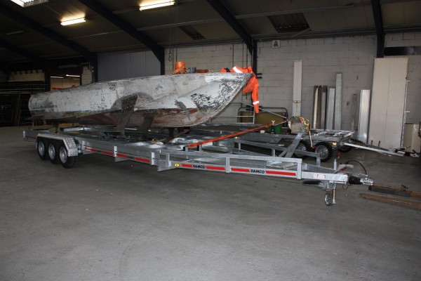

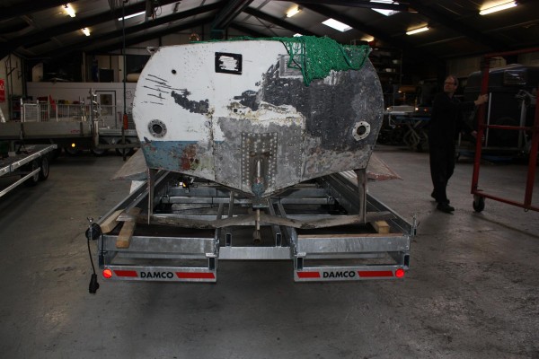

A couple of months ago, i have putted the autocad trailer design pictures on the site. Now, the trailer is for 90% finished. It drives like a dream behind the car and the slide system works great. Now we only need to make a structure on top of the slide system and at the back that will have the exact measurements of the wings. Also, we need to make a stop, so that the wings can be locked.
I'm really happy how it turned out. It has become an 11 meter long 3 axel trailer, and ways 1100 kg. A bit overdone and to long for our light volga's, but now i can transport a lot of different kinds of boats.

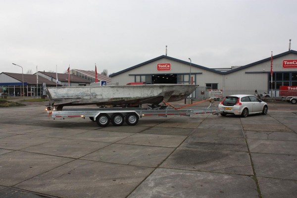

Yep, you can use it for free, if you live in Holland. If you want to use it, be my guest! Here's a nice picture from the trailer and volga behind my volvo :shock:
You understaind how people reacted to see this combination on the Dutch roads. Actually, the transport went really smooth....
