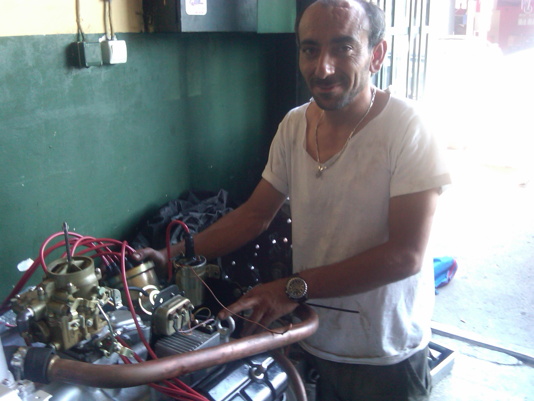

We had one Usta (Maestro) coming today to visit the workshop.
He measured and connected everything.
I think he solved the problem
.... atleast this is what we can see here... !

Re: GAZ 53L 4,3L V8 Engine Electronic Ignition
Post by christian tabakoff »
Nice pics. Joro.
usta did a good job, very tidy!
I like the copper tubing for the cooling water.
and if it runs like it looks it will be great!
does the engine have a hydraulic clutch? converter? it looks so. Than this expalins the 405 Kg weight of the engine...
